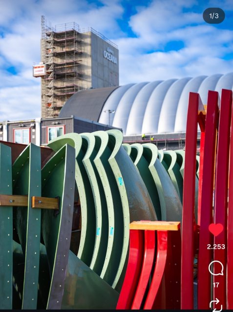

Liseberg is rebuilding Oceana waterworld - expected to be completed in 2026
Liseberg's Board of Directors has July 17 made the formal decision to rebuild Liseberg's indoor water park, Oceana. The water park, which suffered extensive damage in a fire in February this year, has been cleared over the last few months, and reconstruction will start in the fall.
