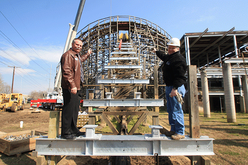

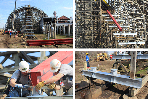

Der Texas Giant bekommt im Rahmen eines kompletten Makeovers neue Schienen, und zwar aus Stahl!
Eine Interessante Methode um aus einer alten Holzachterbahn wieder was vernünftiges zu machen.
Hoffentlich schaut sich CF hier was ab und lässt Bahnen wie Meanstreak überarbeiten!
Amusement Today
Six Flags Over Texas introduces new track design for Texas Giant renovation (Mar. 3, 2010) The Texas Giant's $10 million makeover officially got underway this week at Six Flags Over Texas.
Six Flags Over Texas Park President Steve Martindale, left, and Fred Grubb, owner Rocky Mountain Construction, point to the new Iron Horse Coaster track being installed on the Texas Giant. The first-of-its-kind track design is just part of a $10 million makeover the wooden coaster is receiving. When complete, the super hybrid coaster will open in 2011 for the park's 50th anniversary celebration.
During a press introduction Wednesday, the Arlington, Texas park, debuted the newest in track design for the traditional wooden coaster with the unveiling of Iron Horse Coaster track. The steel I-beam design is the result of three years of engineering. The Chinchillian Red painted track is not bent, but is cut, then welded together in 40 to 53-foot lengths before being bolted to the Texas Giant's wooden support structure. The new track design does not use any wood on the track bed, nor does it use any track bolts. A newly engineered galvanized ledger design, that the Iron Horse Coaster track bolts to, acts as the spine/backbone for the steel railed track. Weight of the new track is said to be about the same as the former 9-ply wooden track complete with steel track and track bolts.
The park also announced that when the new Texas Giant opens in spring 2011, it will stand 153 feet tall, 10 feet taller than it is now, feature a 79-degree first drop and will incorporate numerous 95-degree banked turns throughout the ride. The coaster will also be faster, reaching speeds of 65 mph.
"This ride is going to take the entire industry by storm," said Steve Martindale, Six Flags Over Texas park president. "Six Flags has built a reputation for developing original ride concepts and the Texas Giant will be our crowing jewel." Construction of the super hybrid coaster will be done by Rocky Mountain Construction Group of Hayden, Idaho.
Other details about the Texas Giant's renovation have yet to be to be announced
amusementtoday.com

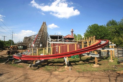

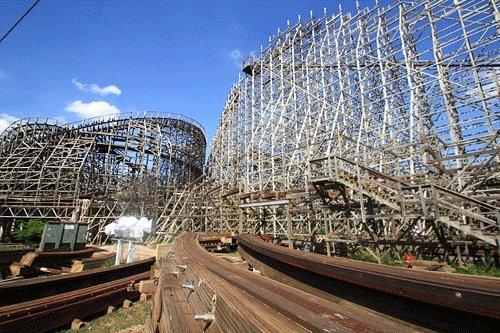

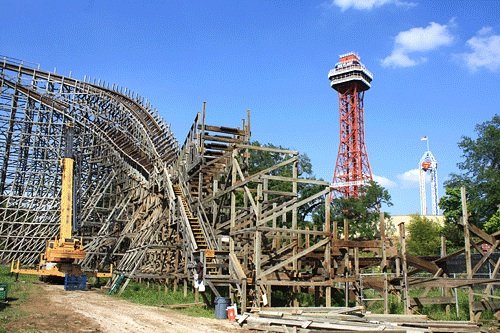

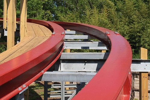

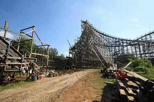

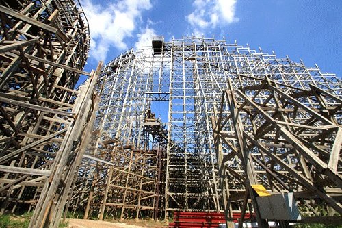

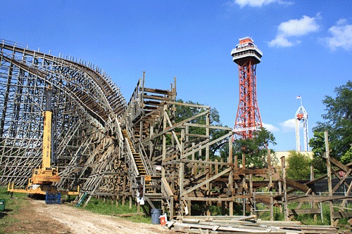

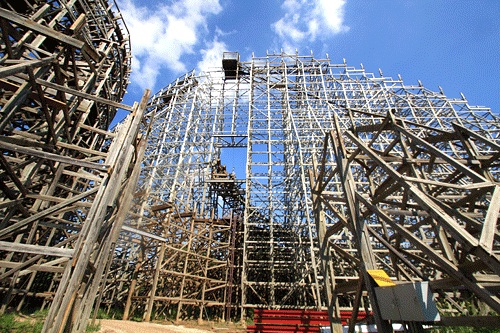

Das Update ist jetzt zwar nicht mehr so aktuell aber ich dacht mir ich stells hier einfach mal rein, der Vollständigkeit halber. S
Amusement Today Texas Giant track removal surpasses halfway mark
The massive $10 million overhaul of the Texas Giant wooden coaster at Six Flags Over Texas reached another milestone late last week when construction crews reached the halfway mark on the removal of the wooden track. A new and innovative I-Box Steel track system is being added on the ride, with the first curved section having been installed between the transfer track and base of the lift hill. Rocky Mountain Construction of Hayden, Idaho is overseeing the coaster's makeover. When the ride opens next season it will also feature a new and innovative train design from Germany's Gerstlauer Amusement Rides GmbH. The park is describing the new coaster as a 'super hybrid'.
Quelle: Amusement Today

Grottenhäßlich, der rote Track! Smilie :122: - Maxi - 125900 Zugriffe

Nach der Montage wird der doch bestimmt noch gestrichen...

Bezweifle ich stark!
the turbine Grottenhäßlich, der rote Track! Smilie :122: - Maxi - 125900 Zugriffe
Finde ich gar nicht! Mir gefällts...
Link zum Beitrag #784042 Verfasst am Samstag, 08. Mai 2010 16:01 Relax
mico Nach der Montage wird der doch bestimmt noch gestrichen...
Klar wird der noch gestrichen - der wird, wies es sich gehört, wieder demontiert und am Boden lackiert! Smilie :25: - Dr. Weizenkeim - 2118331 Zugriffe
